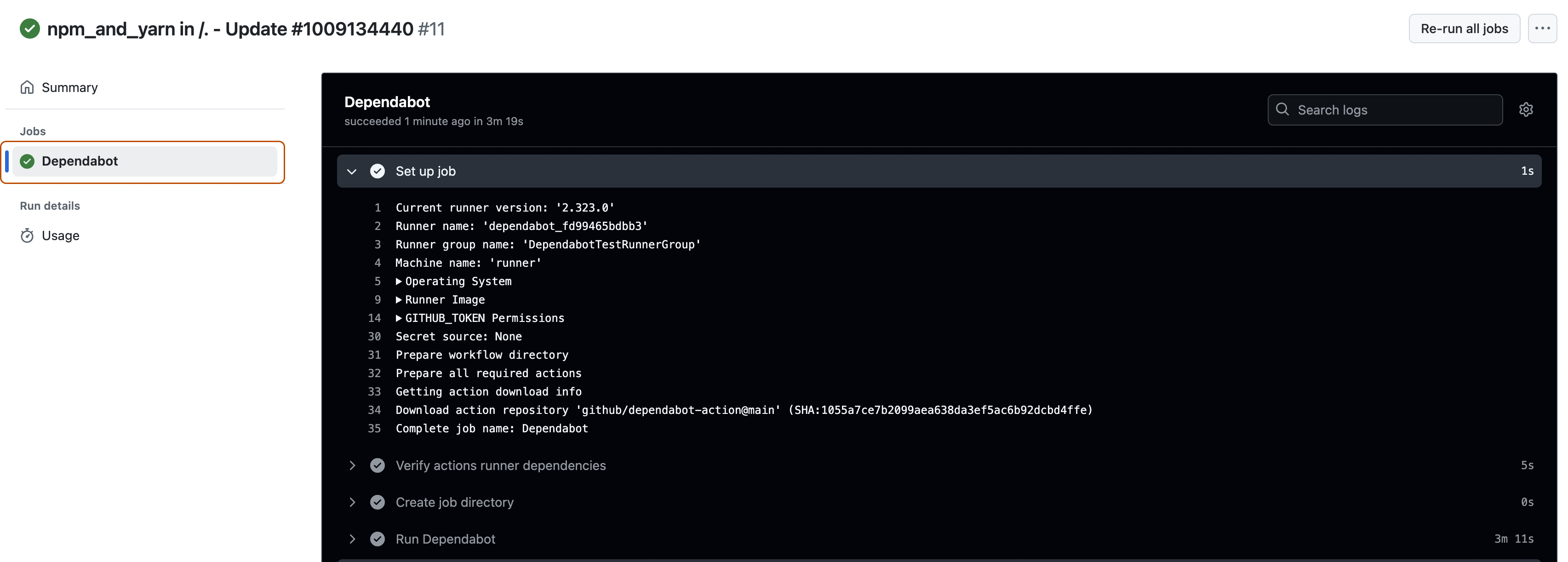

Checking logs and active jobs for Dependabot updates
  • You can view the logs of the Dependabot workflow in the Actions tab of your repository. Ensure you select the Dependabot job on the left sidebar of the Actions page.
    Example of log for a "Dependabot in vnet" workflow. The Dependabot job is highlighted with an orange outline.

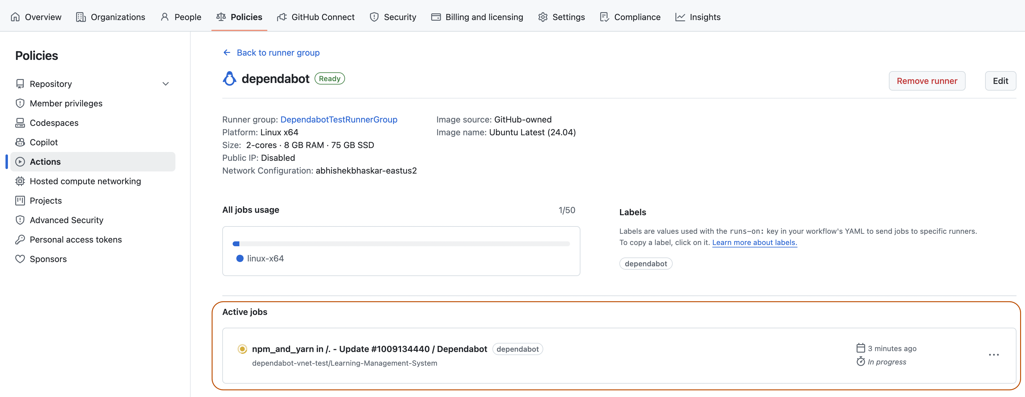

  • You can view the active jobs in the page containing informatuon about the runner. To access that page, click the Policies tab for the enterprise, select Actions on the left sidebar, click the Runner group tab, and select your runner.
    Screenshot showing a Dependabot runner's active jobs.
